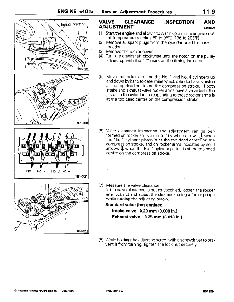

Suspect those mech dosen't have professional menthod about value adjustment? Have tappet sound after that overhaul?
