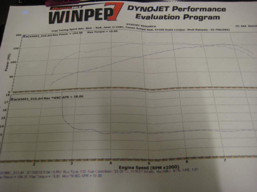

Hi all,
would like to know those sifu with piggyback or standalone user, wat is the AFR you using for you 20V? i know most of the Malaysian Tuner will set around 12.5 to 13, but can we set the AFR like 13.5 to 14 (high rev, full throttle), how the engine life span? The question is ask becasue now my AFR is below 13, and is very high fuel consumption.

As most sifus have posted here, AFR for WOT should be between 12.5 to 13 AFR for NA (regardless of RPM), turbo setup should be even more richer. The rule of thumb is to have a smooth AFR which will make the engine run smoother and more even power delivery (powerband). As for cruising, the stock ECU is already doing a good job keeping it between 14.5 to 15.2 AFR. It is also recommended to monitor the EGT as running "too lean" during WOT could increase your EGT which could result in quicker wear & tear or even cause damage on running parts.
FYI, a stock ECU at WOT (with VVT ON), the AFR will start at about 13 AFR and go down to 11.5 AFR during high rev. However, I've also noticed that the AFR will still try to remain between 14-15 AFR although you are revving between 5000-6000rpm with TPS below 25 % (still in closed loop).
As for thread starter, I think it is expected that your FC will skyrocket because if you didn't notice, your engine is pumping out 154 bhp!. This is roughly 25bhp more than a standard 20V BT's output dude. If I was aiming for that kinda power, FC would be least of my worries ;)
