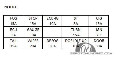

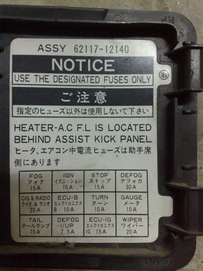

CASE CLOSED. REFER TO PICS. AE101 & AE111. tq
Left diagram = AE111
Right Picture = AE101

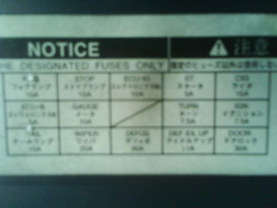

this 1 ker bro?
but this 1 is from my ae111 local seg.
sorry for bad picture quality. picture taken with my phone
yeah this one bro...but can't see anything bro and i think if i'm not mistaken, it should be different?
thanks for your efforts bro! :driver:

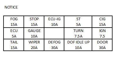

Bump: anyway, this is actually the diagram....
thanks bro me2kimi...
but why is urs different?
attached is the one i got from Ivan's car...
i dont know. maybe u're right. there is a different between ae101 and ae111.
Oh...from 111 there are differences...
Thanks for your input though. Now forumers will have both AE101 and AE111! :-)
