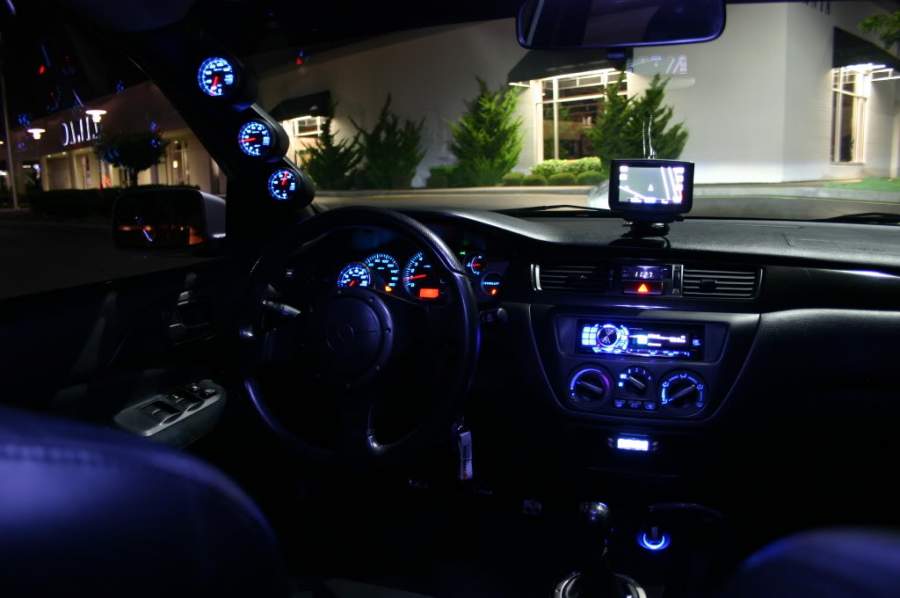

are you thinking about something like this?
:rofl::thefinger: Bro, think there's many examples of the set-up on JDM Evo laa ... u give the brother the USDM ...later he scratch his head on how to change his steering column to left hand side ... :rofl:
Anyway, as long as the TS gets the picture can liao ...:biggrin:
