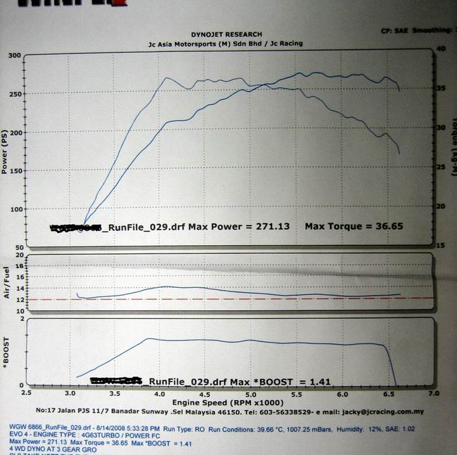

hi guys,i am not mloc fans.last year i bought mitsubishi evo4 transplant with evo6 engine done by previous owner.after 8 month used in boost0.9bar i plan to do top overhaul and minor mod.after my mechanic take out the engine head, he said my engine not a stock! piston change already..87mm size! probably Fairlady VG30DETT piston.also 1.5mm HKS metal gasket.intercooler and cams from TME.Turbo from E7 (TD05HRA-16G6-9.8T)..after overhaul completed my compression ratio only 7.8:1 ! isit too low for 4G63 engine? i dyno it and only can gain 271.1hp on wheel..boost 1.4 bar run with PFC Commander and 255lph walbro fp. the question is what the best compression ratio for evo engine? i got feel more G force and I curiously why my HP like stock engine? How to gain compression ratio? all evo sifus pls help me??

correct me if i'm wrong, but the 1.5mm gasket probably lowered the compression?
I have similar setup and intend to boost high. That's why the compression is lower than factory 9:1. You should get more power with 272 cam :)
