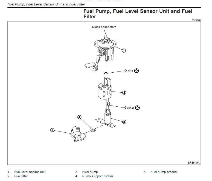

Fuel filter got to change every specific interval just like air filter. If you take out the old one and pour out the petrol you see how dirty it can be.
Confirm under the back seat, attached to the fuel pump ...
I need to change mine also lah.. will check how much it cost :)
Wah A33 such a pain to change. Chances are you would have to change the rubber seal for the fuel level sensor or else will get fuel smell into the car. Lucky A32 not like that.
just got it changed at 148kkm. That thing cost RM95. Same filter being used in N16.
Follow the instruction given in manual. Remove the fuel pump fuse, then start the engine and let the engine halt. Then crank 2 or 3 times to make sure the fuel pressure are fully released. Then remove ground wire from the battery.
Even though pressure was release, fuel still splash out while removing the fuel line from the connector. So make sure you cover it with cloth while removing the fuel line from its outlet to avoid kena splash to your rear back rest.
Actually dun need to change as it is as clean as new @ 148kkm.
Did not replace the rubber seal on top of the fuel tank.

Sorry for my ignorance , May i know exactly which item is the fuel filter, Items shown sure looks like a fuel pump to me..
on the second photo, the devices on the foreground are the fuel filters. The canister like on the left (looks clean white) is the new fuel filter.
