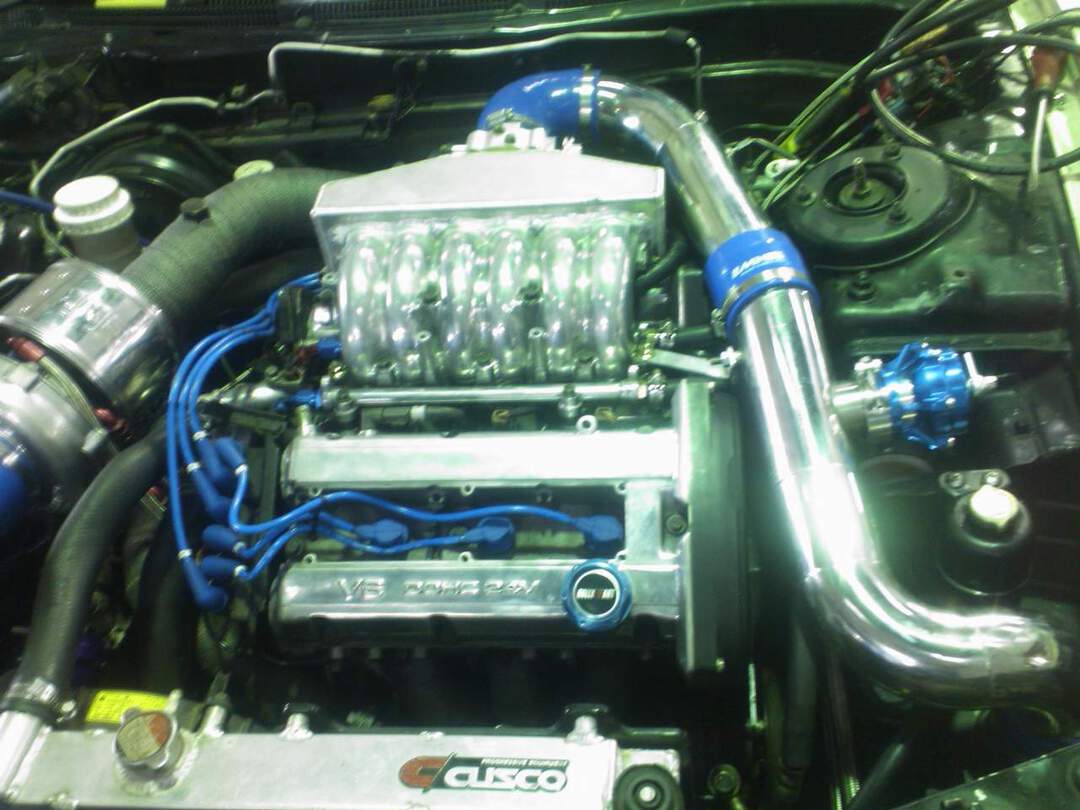

DanzEterna said:
how much total costs for the whole conversion?
About 60k cause almost everything is custom make! Piston, Con Rod, Head Gasket and Piping. The whole engine bay need to re-layout and very time consuming from sourcing to re-build engine taken about 2years. Target 500bhp on wheel.
wow, thats alot of $$$,
how bout just normal single turbo conversion, using AR70, just change the injectors, custom made pipings & add on a piggyback. how much would it costs?
Like that will be much cheaper I think around 15 to 20k however I don't think u have confident with original con rod. The piping will cost u a lot due 6A12 is too complex and not much workshop want to do so unless u have the piping blue print.

The engine won't vibrate with this mounting but the steering is will vibrate like a massage machine during slow pick up! ==! sweating!

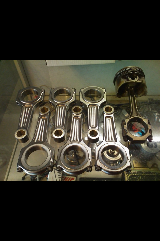

OMG stock 6A12tt con rod so small??? Serious...
And btw, why don't remain twin turbo but just upgrade the turbo? Should be better response, power, less trouble and easier I guess? Why want to single it?

Con rod already change! Initially was thinking to upgrade the twin turbo to TD04 instead however it might need to cut the firewall due to space problem.
