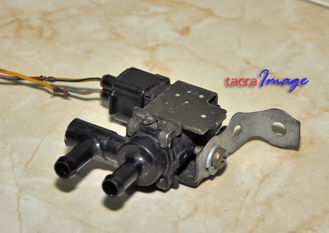

haiz....my old 4G91 got problem again
any one know how to solve it??
once aircon compresor kick in my RPM drop until wanna die off
forman said is TB problem got some gear inside condamn !!
need to change the whole TB
but from my memory
we can modify something to by pass it (parts from toyota) beside change the TB since the TB is so expensive
any one can help??

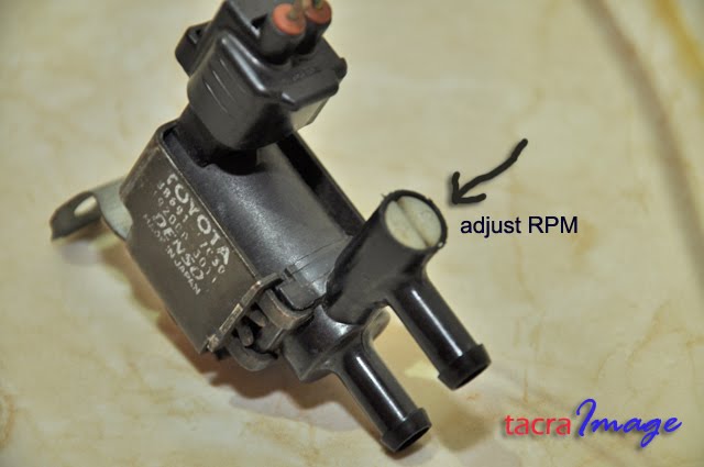

badguy,yeap,sounds like ur FICD problem...common prob on our engines...
yea...the diagram is correct...happy DIY!...or if u in doubt...can alwiz come to my frenz workshop in kota damansara

Yea... My fren told me to tap bullet... He was sayin if tap compressor will experience some "lag"... Anyway... As long as it does the trick...
Anyway... Its not easy lookin for tis toyota valve... Coz more n more ppl know its usefulness.... Its not oni used to control ur a/c... Some ppl use it as a boost controller....
some ppl say install FICD is only for temporary at the end u still need to change the TB
how true is this???
