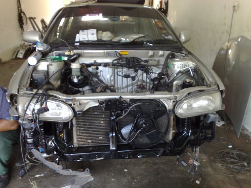

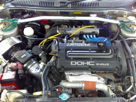

me build my 4g67 from 0-hero like jinkl,rpmracing,rsgang juz to name a few..:biggrin:
here some pic to give u more spirit to build u 4g67 bro...and
it juz to prove that im been trough all the process budy
not more then that....:driver:

bro trinityblood...how much the cost for u to rebore ur block??
now what type of pistons do u use??
i plan to rebore my block n use evo piston..is it ok??
cost to rebore block is not always same..diferent place may be dif charges..
but mine reboring and press the piston is almost rm400,im buying evo3 halfcut
so im using the piston back. After u done rebore the block and used evo piston
it should be no problem at all.we gain bck the 2 liter power budy....:listen:

so bro trinityblood,mind sharing with me how much hp ur monster produced with this kind of mods??
haha...before i done my project im expecting to reach at least gain the same power wif standard evo 3...after all tune wif afc neo i`ll get 10hp more then standard evo.
ok lah since no major mods done to my car....
