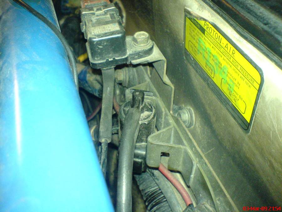

chris,....
Could you check & see picture below?
What devices for & what purpose?:hmmmm:
TQ.

a little bit of this..and a little bit of that..it will eventually sum up to 5k..Hmm not so wise...but then..we are all in this rite..A hobby..car tuning..explore the unexpected..
