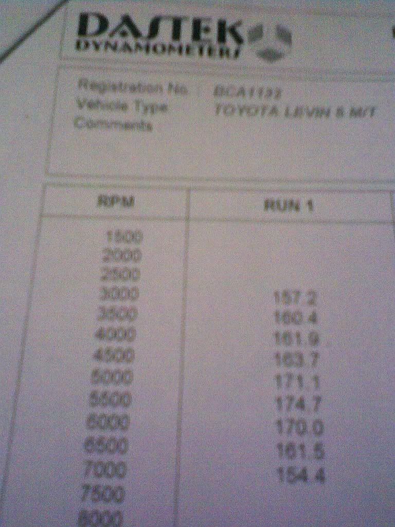

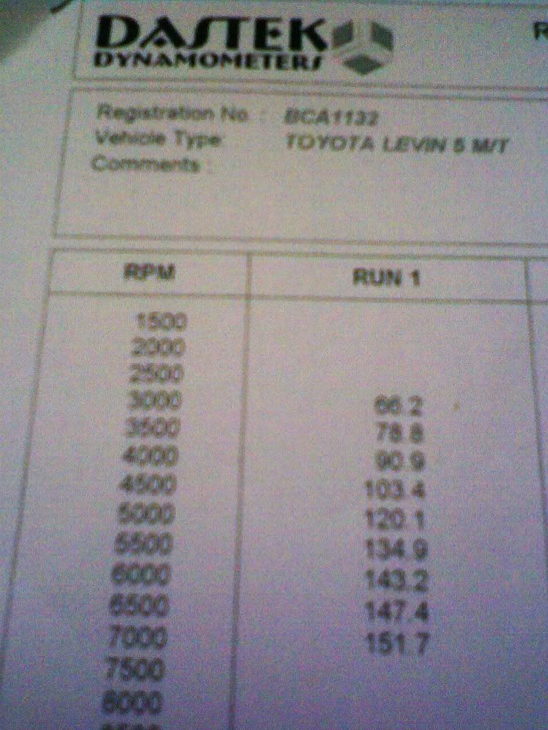

all this very headache issue, bcoz cannot compare straightaway from 1 dyno machine (brand) to another. cannot also simply say this dyno or that dyno inaccurate haha. wanna go to many different dyno machine pulak, no money :bawling:
as for me, i went to a Dastek machine. weird la how they extrapolate FHP from WHP, but i dunno shit oso cannot talk much. the operator said can even know the % transmission loss for each car & not all cars lose the same % of hp via transmission. by this point my brain wanto shut down oledy wahaha :sleep:
Info:
BT head, skimmed 0.5mm
Stock gasket
SVT block, SVT pistons, SVT conrods, SVT crankshaft untouched
Stock cables + BRISK spark plugs
C52 SVT non-LSD; dyno ran on 4th gear
BT flywheel machined to 5.5kg
Peak HP (flywheel - extrapolated): 151.7 @ 7000rpm
Dyno guy told me my car in particular had 20% transmission loss. i forgot to write down the actual WHP but i was told its 130~ish on wheel.
Peak Torque: 174.7Nm @ 5500rpm
very sorry for the blur pics, its the best i could get from my phone camera. :bawling:
an interesting argument between me & my mech ensued after the session. i thought that if i had dynoed with my previous full BT bottom end, id get more happy results. my mech however, pointed out that the lightened nature of BT conrods could lead to less peak & overall torque. issue is still unresolved till now. any thoughts?

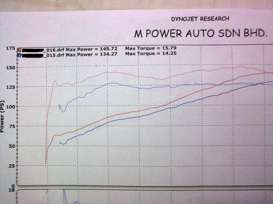

Hardly to get people believe it. On the dyno database, there is other 20v run there too. Stack it and it is real for sure. Lolx .. On the chart, note that there is 2 graph there. Before and after. That was only adjustment on the Fuel Regulator. The horse run up like a scramble boost on it's legs.
Well, when i say stock it is only the Engine. Hope i didn't mislead anyone. Here is what i can share.
Before the chart attached,
Stock SVT, with AFM still and stock SVT ECU, and the rest stock to the bone except Cap Kakimotor big exausht come by 135whp (with C56 gearbox)
After
Stock SVT, with Map and stock SVT wiring + BT's ECU, Fuel Regulator (still 135whp) but super choking effect for opening the throttles :banghead:
Turn turn the Regulator, magic happens. That is the before and after the attached picture. A big surprise. :driver:
Current,
Still break in condition, and will share up if it is a successful story.
Note for you guys, C160 gearbox doesn't change anything on the dyno as well.
So your SVT is actually on open trumpet?
Bump: So your SVT is actually on open trumpet?

I do quite agree on the Cusco P-ball, but shouldn't all other aftermarket extractor bring up the power a bit on a stock BT? In fact, most engines does show some improvement upon installing aftermarket header.... so I'm a little confused now.
Wow... you gained 11hp by just setting the FPR? Mind sharing which brand of FPR are you using and also the fuel press w/ & w/o vacuum. UGPM!
