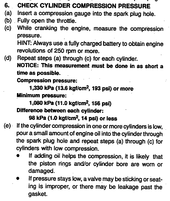

IMO, higher compression pistons and aftermarket cams doesn't necessary mean you'll get higher compression when doing compression checking through the spark plug hole. To do a proper compression testing, its more complicated. Checking compression through the spark plug hole is usually used to identify if there's any compression loss between the pistons mainly due to worn out compression rings. So a spark plug compression test is not the proper way to check for engine compression rating.
Anyways, attached below showing compression checking reference from 4AGE service manual. It says compression pressure 13.6kgf/cm² or more and minimum pressure 11.0kgf/cm².
Hope it helps to clear out the air.
