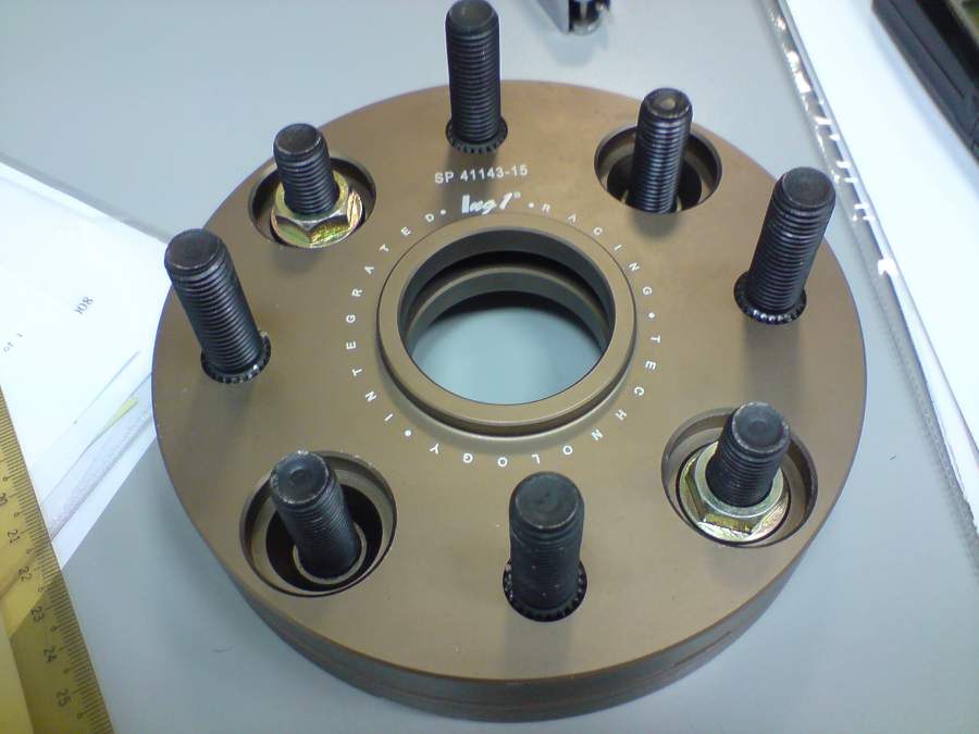

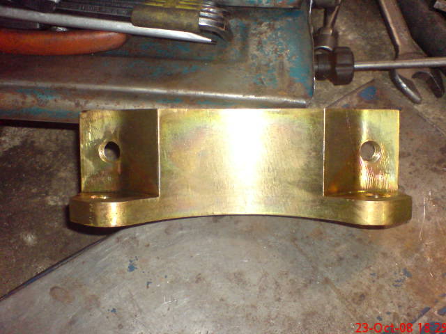

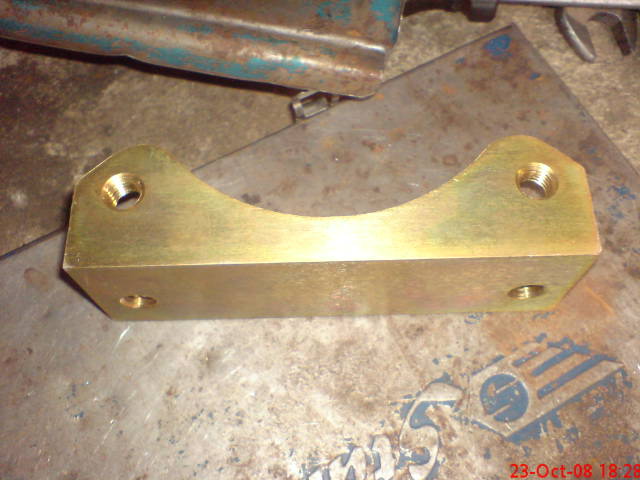

Juzz to share vit you all. Project is now going on. My rims can't go vit the caliper. Too bad:bawling:....need wide spacer atleast 17mm. Measure liao. Custom bracket ready bolt on to the caliper:stupid:

Parts and labour is around RM3800 :hmmmm: Engineering shop which have CNC tooling.I do it at my hometown Ipoh.

2pcs customise brake carrier

1pair 15mm Spacer Intergrated bolts & nuts

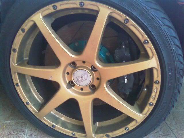

btw,wat rim u using now?offset?mind to post some pic here?wondering the clearance between rim & caliper

mine is 996 front caliper with GTR34 324mm rotor
Here the pic with 17 x 7 offset 25 rim
Massive Clearance
The offset 40 wheel i dont have the pic
but it do clear
just i feel not secure decide to change bigger offset rim
thanks for sharing bro.
Advan touring.
Offset:45
Spacer: 13-14mm from disc.
Clearance:1-2mm(using 15mm spacer)
Advice to have offset 32-35 depends of the design of the spoke. I try to use offset 40 still can't clear. Need to add 5mm spacer. You can use spacer but must buy reputable not from ABC brands.

Nice...Thumbs up. Which model you fitted to?
Mine is from Porsche 996 Carrera Front
On a Nissan Sentra
