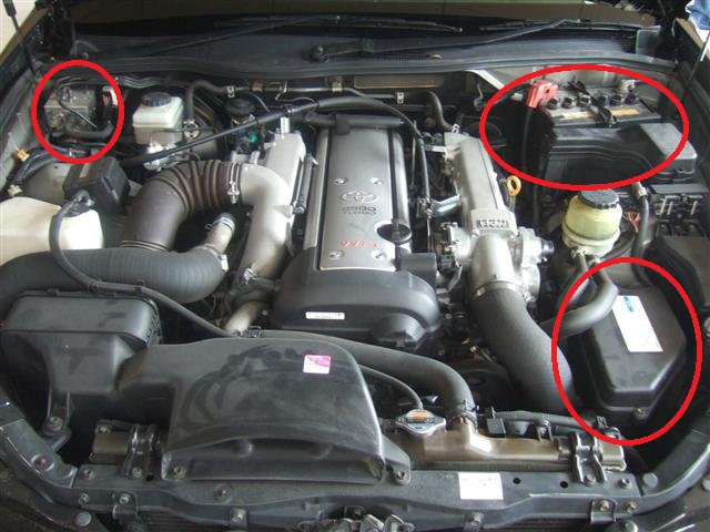

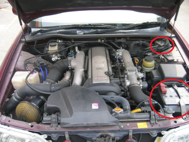

I'm not sure, thats why i'm asking around for answers.
But I've discovered there are few things JZX110 & SXE10 share in common, such as:
- ABS pump
- Battery
- ECU
As for JZX100 ECU located inside the dash, unlike the JZX110 ECU position is just plug & play.
I might be wrong, but do correct me if i'm wrong.
Please refer to the picture below.

your pictures showing 1JZ-GTE and not 1JZ-FSE.
1JZ-FSE is the 'economy' version (eg.3SG v 3SF)

I showed the 1JZ-GTE picture because we are comparing between the JZX100 & JZX110 not the FSE
