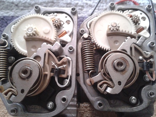

Hello Bro, spot the different. Guess which one is original 1.5 and 1.8 Throttle body.

Left is the 1.8 TB
