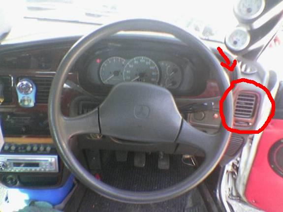

WTA Removing A/C Outlet from Dashboard For Satria/Wira
<blockquote data-quote="king_coolice" data-source="post: 1063385871" data-attributes="member: 36054"><p>You want to take out the whole thing (including the open/close knob) or just the air vent?</p><p>If only the air vent, U need to use a flat screwdriver to remove the clip on the left and right then pull it out. Torchlight helps you to see it more clearly.</p><p>If you want to remove the whole thing, then i cant help u cause I never remove it before.</p></blockquote><p></p>
