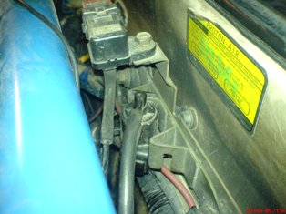

Pls see picture below, what are these devices for & what is their purpose?
Pictures taken from P/Wira 4G13.:wavey:

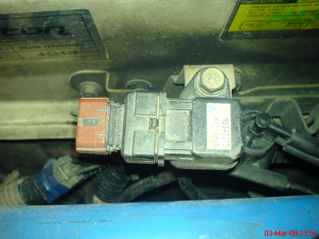

This map sensor for what purpose? to control which section of the engine? Is it the air flow ratio?

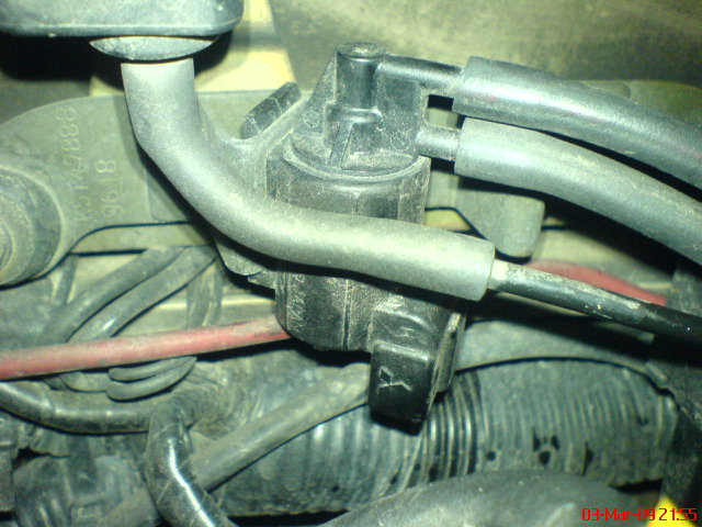

In second pic, small black round with 2 tube on it? For what purpose? vacuum ka?

dat small black round thing with 2 tube connected to it should be ur oem ficd....

2nd pic is the oem FICD, pls have a look..... my car already 10yrs... this device still ok ka? need to change not? scare not functioning well leh? but this device seldon "kong" 1 right?
Any advice ... pls?

map sensor is to detects ur manifold pressure and send the signals to ur ECU

This oem ficd not adjustable rite? not like the Toyota denso ficd which can adjust.
I got 1 toyata denso ficd with me. What should I do???
Add on the toyota ficd (oem still maintain) to engine or replace the oem ficd with toyota ficd? how to DIY to get better idle when air-con compressor kick in.
Pls,... advice!:itsme:

why u wanna adjust ur a/c on idle rpm??... not happy with it??...
if ur idling is ok..thne dun need to change it...
if ur rpm going up n down,up n down..then only u instal the toyota ficd.

emm... yes. not happy cos not stable some time ok some time not. This cos during a/c compressor kick in.
ori a/c compressor small unit. But last time "kong liao" than changed recond a/c compressor big unit not sample as previous one.
So, how huh.... any idea ke.:sleep:

Should I change oem ficd? replace a new oem ficd to see further result?
Or it might be the mechanical issue ne...? cos khguan said usually is mechanical issue wow.
Any idea, pls advice.
the ficd easy to install only..2 wires and 2 hoses..u can try to instal.if its solved..then kawtim, if it stil d same.remove it lo

Actually, before this. I tested edi, he... he... kenny u never see it meh. during the time u helped installed the VS+ground cable the toyota ficd is there liao lo.
result was still the same during a/c compressor kick in the rpm will drop to 600 than went up again 800. I felt that the reaction when a/c kick in the ficd running slow but some time ok some time not.
I also dunno what to try on liao lor. That's why I got toyota ficd lor.
But when I tested the toyota ficd, the oem ficd I never take it off & remain untouch. Using both ficd on same time wow? it may give any bad effect or not?
Any advice... TQ:adore:
