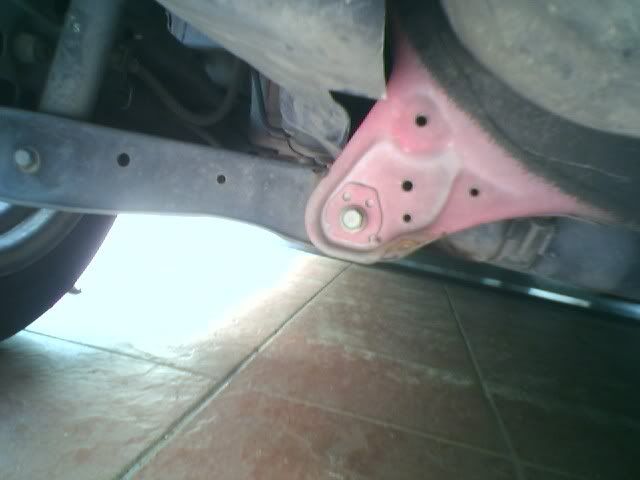

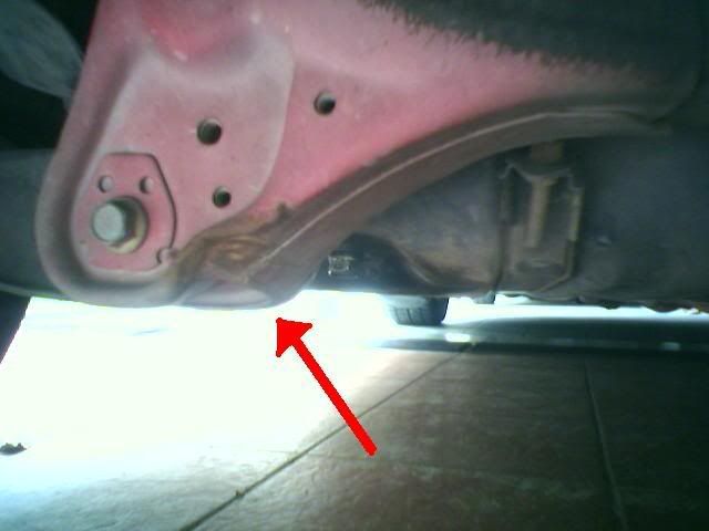

<blockquote data-quote="xxxx" data-source="post: 1728913" data-attributes="member: 9296"><p>shiro,</p><p></p><p>tat ruler thing is called REAR LOWER TIE BAR ler......</p><p></p><p>and it's NOT for cosmetic purposes....</p><p></p><p>furthermore, it's not meant to work in the direction where u bend it, front n back, it's meant to be pulled sideways....</p><p></p><p>rear lower tie bar increases your vehicle's torsional rigidity by bracing the rear lower control arm sheetmetal mounting points.</p><p></p><p>By connecting the suspension points with a rear lower tie bar, the chassis' rigidity and handling characteristics are improved while distortion under hard cornering is prevented</p><p></p><p>so do u understand the function of the bar now? haha.....</p></blockquote><p></p>
