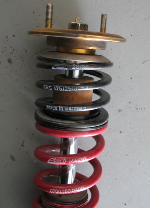

Hi all.. as per topic.. anyone here know where can i get the tender spring? it is usually seen at tein hr.. a smaller springs to help damping the main spring for adjustable.. as shown in pic the black colour spring.. thank you~

anyway.. tender & helper springs are two different types, although they look similar. tender springs are softer than main springs & may help with low speed dampening. helper/assist springs are a lot softer and fully crushable when the tires are on the ground. helper springs will keep the main springs intact under full droop.
tender springs may help on height adjustable only. for body shift design, you don't one. like others have suggested, better use lower spring rates for more comfort. knowing the car and the stock spring rates also help to determine requires stiffness.
