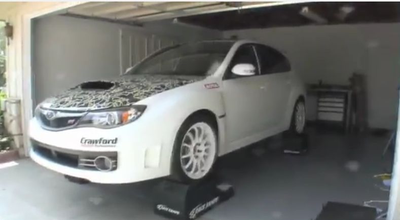

I watched Youtube videos depicting how UR installs swaybar/anti-roll bars. In them, I see the cars getting jacked/raised above ground level for the bars to be installed. Final tightening were performed with the wheels off the ground.
Can't help wondering how this can be correct. With vehicles off ground level, the cars aren't at their normal ride height. If you tighten & lock the bolts in this position, when the cars are returned to their normal ride height, the bar should experience some movement. Will this not induce some preloaded twist into the bar?
Any thoughts guys?
ARB are not tighten to a fixed point where there is no movement. It supposed to move to counter the right to left and/or left to right, so to me no issues
preloaded eh. I never thought of it that way. There's bound to be *some* load but it's minimal since most of the forces will be taken away by the links I suppose?
A bit difficult to put into words what I mean. Please have a look at this youtube video. http://www.youtube.com/watch?v=S-7whf5jCd4&t=42
In the video, it showed the swaybar end link at full droop. With the wheels off the ground, swaybar hole vs endlink will be misaligned. If the bolt is tightened at this position, when the car is lowered back to it's normal ride height, we're preloading the bar with some unwanted stress.

I saw one guy used a ramp
attachment.php
Another used a separate jack to raise the lower arm
http://img.photobucket.com/albums/v38/PatrickGSR94/MyIntegra/2010-04-01_Suspension/IMG_6165.jpg
Alternately, find a tyre shop with a hole in the ground
usually there is gap of the nut holes to adjust the nut position, so after installing does not have to tighten the nut all the way, get the car down as low as possible for installer to get in & tighten it, so lesser stress than when the car is way up.
Think with most rear ARBs, we can squeeze under the vehicle to tighten the bolt. It's the front that is difficult.
