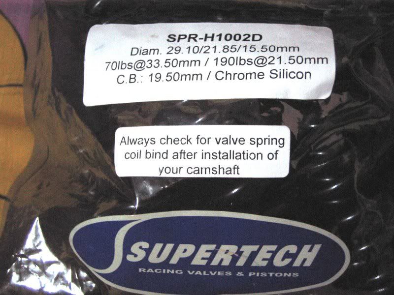

<blockquote data-quote="alex27" data-source="post: 3517065" data-attributes="member: 39307"><p>Ok i get it. Stage 1 cam using type r v.spring. One last question hehe stage 1 is intake 11.9mm exhaust 11.0mm compared to type r intake 11.5mm exhaust 10.8mm. These are d new specs. D old specs are similar to type r. So with the new specs i can still use type r v spring?</p></blockquote><p></p>
