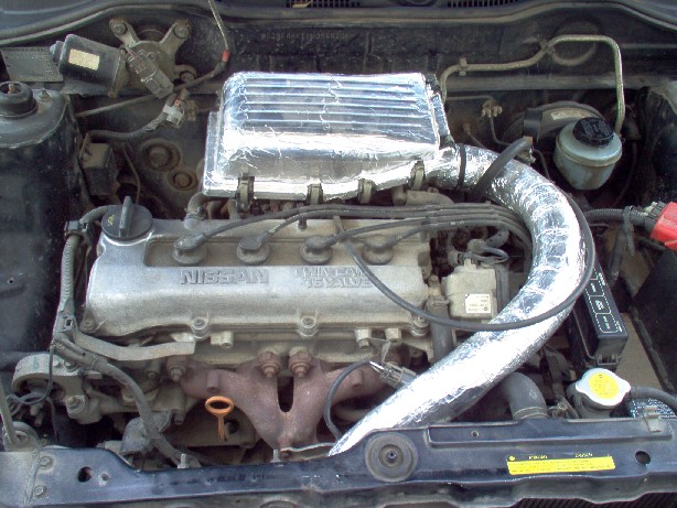

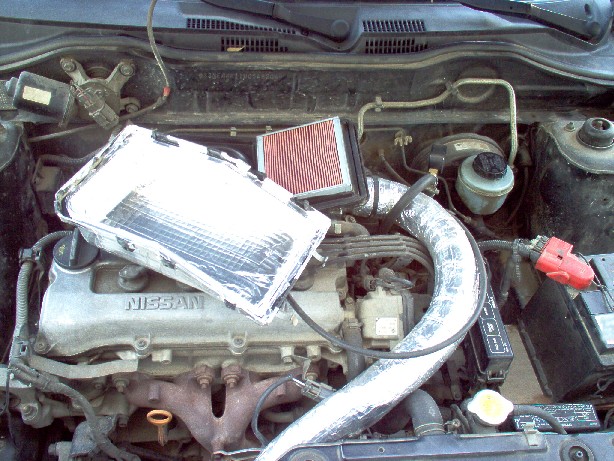

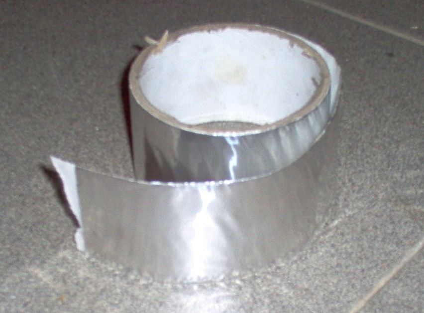

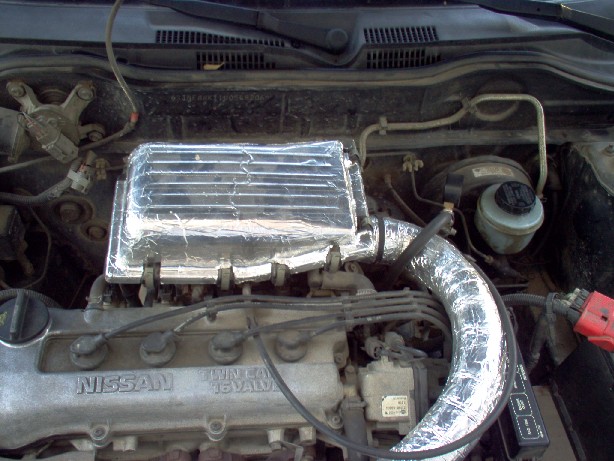

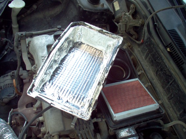

<blockquote data-quote="servo" data-source="post: 198308" data-attributes="member: 1665"><p><em>for references n info.....taken from Micra sites....any ones???</em> :D </p><p></p><p>This is a simple mod that you can do to every stock micra. </p><p>You will notice a better response and better acceleration. </p><p>Parts needed: </p><p>Aluminium tape </p><p>+- 1M of 60mm flexible paper tube. </p><p></p><p>1. isolate whit aluminium tape the air filter box ,in and out, this will create colder air box. </p><p>2. extend the flexible tube to the front grill , take him out and isolate whit aluminium tape . </p><p>3. that’s it! </p><p></p><p>since aluminium tape as heat reflector properties the inside of the air box and intake tube will be colder than the outside </p><p></p><p>[ATTACH=full]591724[/ATTACH]</p><p>[ATTACH=full]591725[/ATTACH]</p><p>[ATTACH=full]591726[/ATTACH]</p><p>[ATTACH=full]591727[/ATTACH]</p><p>[ATTACH=full]591728[/ATTACH]</p></blockquote><p></p>
