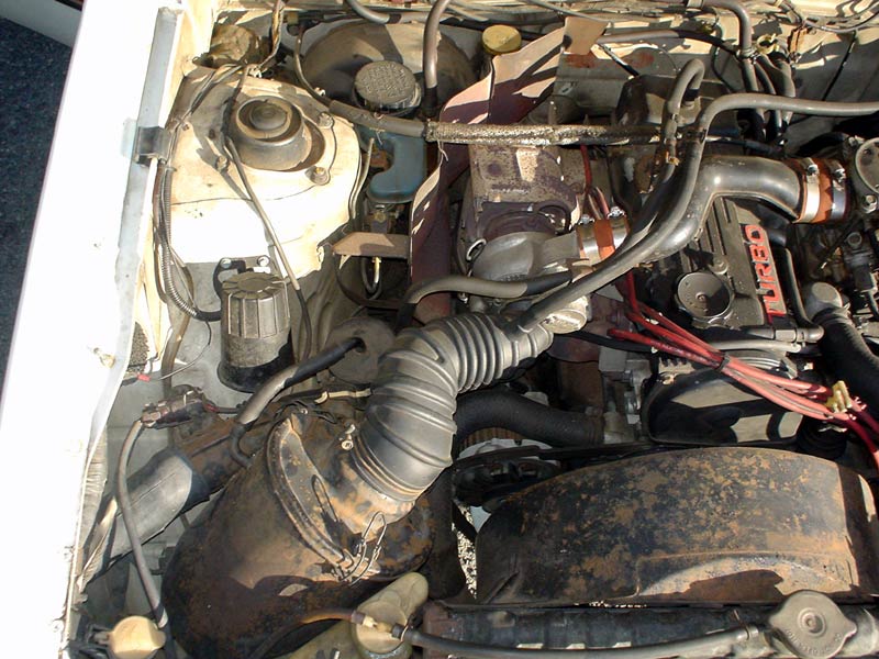

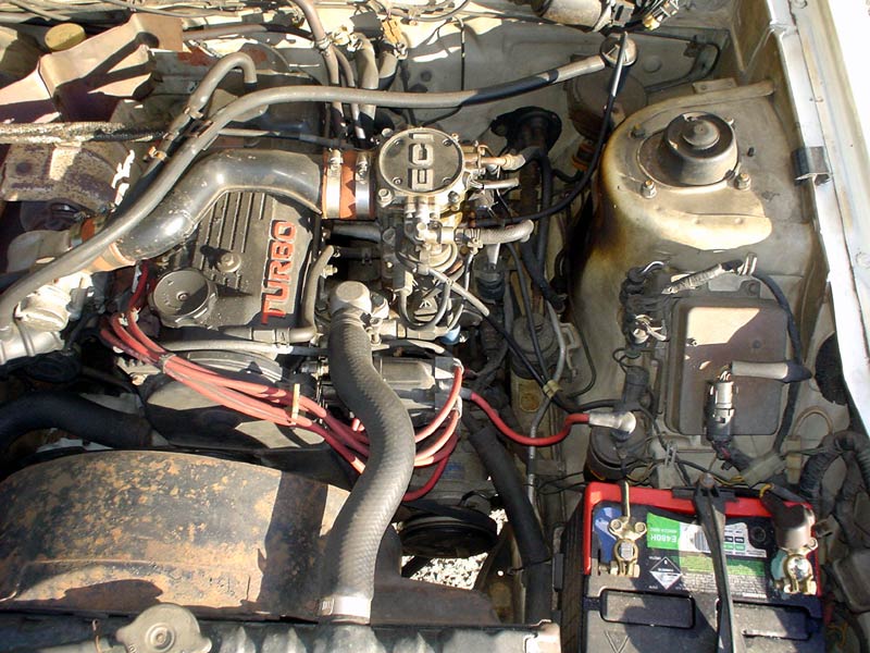

bro if u want to plug n play i have 1 halfcut sigma turbo GT 1982 bro....2liter turbo ECI single cam... half cut come 1 car includding roof,4door,rear bonet...includding kastam form n AP...price RM5.5k....if u like u can call me 0142998807....or come to my garage to see 1st....loc/kuantan....u can plug n play bro....no neet to mod driveshaft....:biggrin: n 1 more it come with rear axel.....all item ORI sigma turbo gt 2liter...year1982......

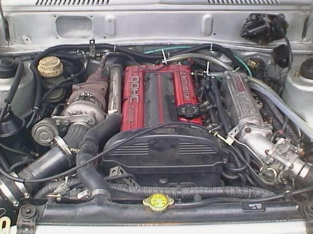

Evo 3,
Is that you show the engine is the galant sigma bay?? Look nice fit in it...But how about the modification..I it many thing to modified..??
yup..that a sigma engine bay. belong to one my friend. you just need to modify the tapak, position of the turbo and the water pipe. ;p Battery relocated to the back. GB if not mistaken, use back sigma cos i don quite remember already.
RB26 engine need to cut the chasis a bit. currently one sigma in my workshop half way "masuk" RB. My neighbor "masuk" 1j in his sigma. I also own a sigma planning to masuk turbo. Hope u can keep us updated on ur project for future reference. heheheh. :wavey:
