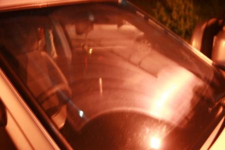

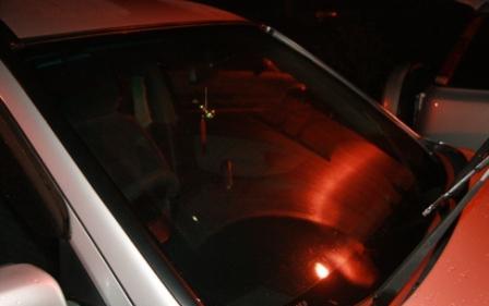

Recently bought a Pro******* Brands Rain Stain Removal, it really removed the rain stain. I applied it to all my car's glass mirror including both side mirror as well. It gave me a good result. However, when come to the front mirror, oh .. god..! I realized that the rain stain has gone, but it gave me a big trouble. The front mirror become matte surface, blur on the surface. It cannot be removed even I applied the rain stain remover for few times. I dunno what happen. Do anybody know how to solve. Why this product with an award records can make this thing happened?
It make me difficult to drive in day or night due to the vision from the glass.
My photo explain everything.

will sand paper leave mark? maybe a 2000 grit ?
try Rain-x, to remove it, maybe u'll should use a buffer...
hmm...you should have asked around first before start using this stain removal. based on your pic, this is almost similar like another brand call tomcat which contained high concerntrated acid. if your windscreen got micro scratches/holes, then this liquid will fill in those gaps and create result like foggy/matte. 2yrs back, i heard this is very hard to get it removed. i think you need to google and see if any forumers successfully get it done.

As what you mentioned the product give you good results but unfortunately you did not read the instruction. The instruction has clearly stated CAUTION-DO NOT APPLY ON WINDSCREEN WITH RAIN REPELLENT, DO NOT APPLY ON COATED MIRROR,... The problem occured due to your windscreen with rain repellent. IT IS NOTHING WRONG WITH THE PRODUCT BUT ONLY YOUR HANDLING MATTER.
The only way to minimise the matt surface is to polish the surface with rubbing compound.

sent for glass polishing or if u have the time and elbow power, polish it
gonna be hard
this occur cause everytime u use your wiper, ur glass is too dirty (sorry to say) and too little water was present this resulting in fine scratches on your windscreen

look like the product bonded to the surface. Its either ur surface wasn't clean before you apply or there is a coating on your windscreen and when you apply the product its someone 'burn' that coating...
Have you try reapply the product...and see whether is can be remove ?
* Never be stupid SANDPAPER your glass, Glass is way harder then your paint and clear coat...or even sand paper...unless you using very hard object to scratch is - alike stone or crystal, then only it get PERMENANT scratch....
Why so defensive and worked up? Are you a rep form the company? Come on, people already have trouble here. If he did a mistake, he did a mistake. No big deal about it. If don't have suggestion to help, just don't flame him. If you got such problem on your car, how will you feel? Then kena flame again.

How are things bro? Send for glass polish or if you got polisher, try do yourself. Do update us with the progress ya... Don't worry. I don't think it is something unfixable. :burnout:
+1 for the rubbing compound..
from my 1st car,it never fail to do the job.just make sure to keep ur paint away from it..:adore:
