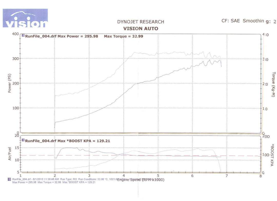

Please comment on my Dyno chart
<blockquote data-quote="?nDc?s?ve" data-source="post: 4408501" data-attributes="member: 17327"><p>imho bro.. its all in the tuning, get a reputable tuner to diagnose your situation.. from there he will advise you as to wic hardware is in need of replacement(be it your 02, injectors thou it shouldnt be the case as its duty cycles can be set accordingly and etc) or its just pure bad tuning to begin with..</p><p></p><p>its really hard to tell the prob from just your dyno as it reflects WOT results for max output but more often than not its the part throttle tuning that effects your everyday driving.. this can be viewed via the data log which your tuner can have access to.. just afraid you need to invest a lil more but i believe it will be worthwhile in e long run buddy..</p><p></p><p>and yeah kinda surprise bout your torque.. abit low, on my old setup.. my stock turbo was hitting almost 43kg-m on e same dyno..</p><p></p><p>gl buddy</p></blockquote><p></p>
