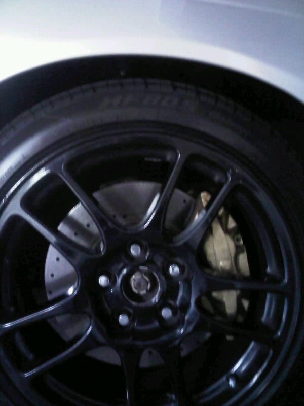

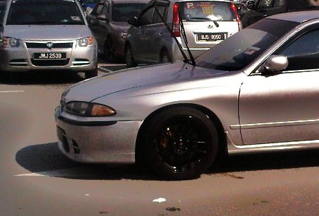

hi dreamZz..
Fyi, i have change my original brake to Toyota Aristo model..
For the performance, i dont think we need 4pot for standard perdana, even for perdana with evo engine, 2pot is already good for braking unless for heavy track use, u might consider to have 4/6pot..
there are 2 ways to install this thing into your perdana..
1st: modify Aristo disc to 4 hole
2nd: modify your original hub from 4lugs to 5lugs.. =) - must change new wheel set
both modification need new bracket for caliper..
You also need to have at least 17" wheel with proper offset at least 35..

basically most 4pot calipers could fit into perdana, just to fabricate the bracket is expensive.
