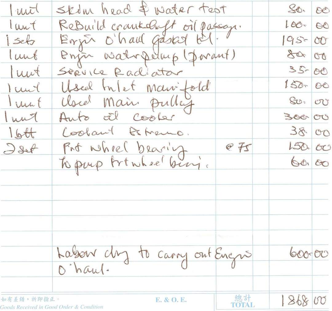

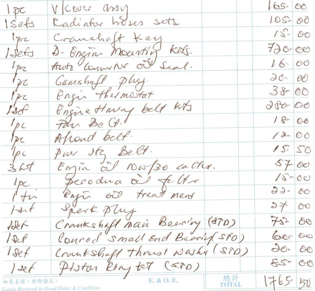

Thanks all! Decided just to overhaul. Removed rocker cover and found that the previous mech cut the baffle plate off totally to replace the plug seal but never installed it back!! No wonder oil kept coming out from the rocker cover. I installed a oil catch tank and found that it was full of oil after 1 1/2 weeks.
Check it out, it this quote ok for a full engine overhaul?
