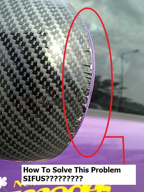

<blockquote data-quote="E-Tech" data-source="post: 3941585" data-attributes="member: 14975"><p>From the picture...</p><p>You only did it on the outside and the egdes never fold it in.</p><p>No choice have to redo...</p><p>Don't be lazy... take off the side mirror, remove the mirror if needed so that your can</p><p>folder about 10mm inside. Heat, pull and fold it in...</p><p>Good luck....</p><p></p><p>Some show can spray th cf look.</p><p>That might be best for items with angled corners..</p></blockquote><p></p>
[QUOTE="E-Tech, post: 3941585, member: 14975"] From the picture... You only did it on the outside and the egdes never fold it in. No choice have to redo... Don't be lazy... take off the side mirror, remove the mirror if needed so that your can folder about 10mm inside. Heat, pull and fold it in... Good luck.... Some show can spray th cf look. That might be best for items with angled corners.. [/QUOTE]
