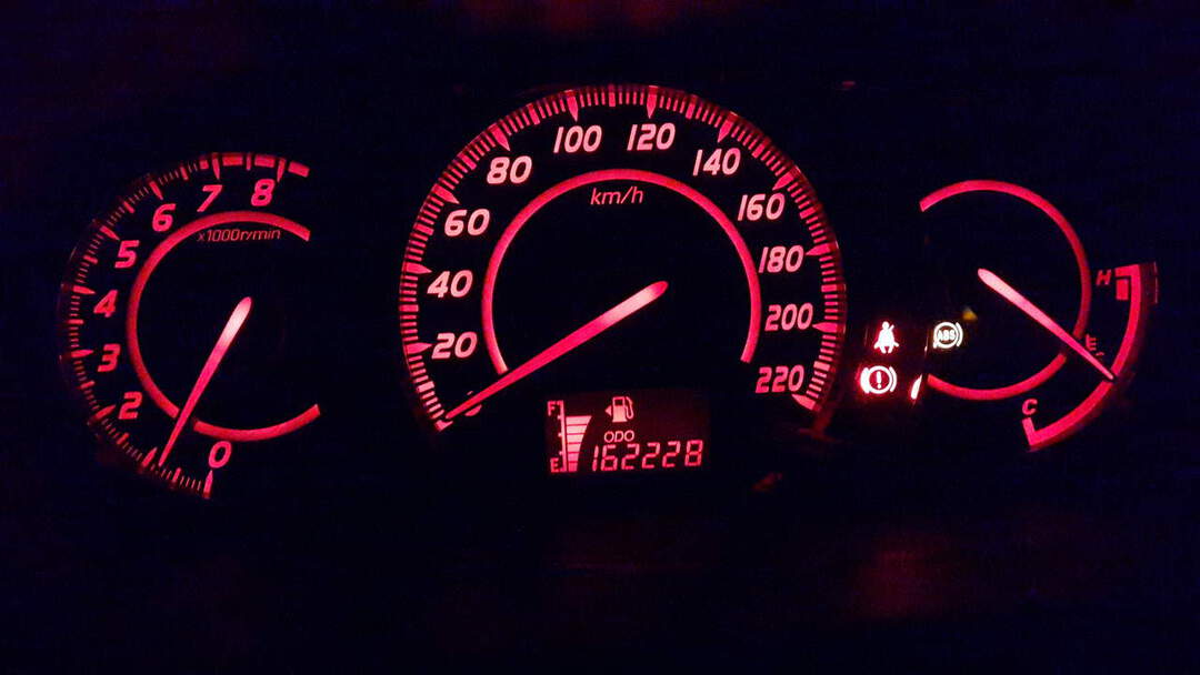

<blockquote data-quote="gunnerzz" data-source="post: 1064537605" data-attributes="member: 166532"><p>If the fluid level is well and all connection are in good shape u can try cleaning the abs sensor on each corner.</p><p>Its a long shot but cheaper than replacing the module.</p><p>If its still lights up after cleaning then chances are the sensor is faulty.</p><p>Still, best to send it to a shop with diagnostic tool.</p><p></p><p>On my Waja if it lit up and i know my sensor are clean and the module is good, its a sign of weak battery.</p><p>I know the ABS light will be followed by the gearbox light short after.</p><p>It only happen when stuck in jam or at low speed.</p><p>Additional grounding seems to help in some case.</p><p>Pull once cable straight to the ABS ground point, i did just that.</p></blockquote><p></p>
