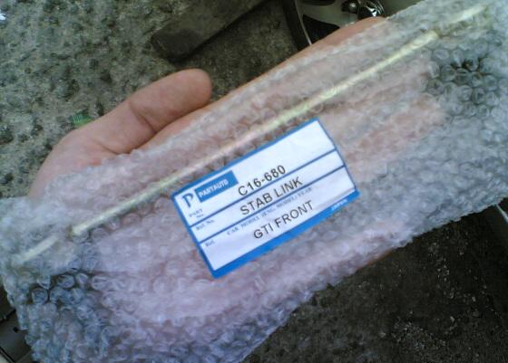

Sifu has spoken :adore: GTi ones are mounted on the absorbers. Evo 1-3 ARB will fit in GTi but not GSR or normal satria as it is mounted on the lower arm. Even after you have the ARB, you'll need the stab link to connect your ARB to your absorbers.

I think satay bush = stab link (Correct me if Im wrong). Anyway, if ur sourcing for good aftermarket ARB, u can go for Whitelines. Few of our GTi members are using Whitelines ARB and it works like charm.

Stab link should cost RM 50 below for taiwans.. slightly more for OEM proton.
