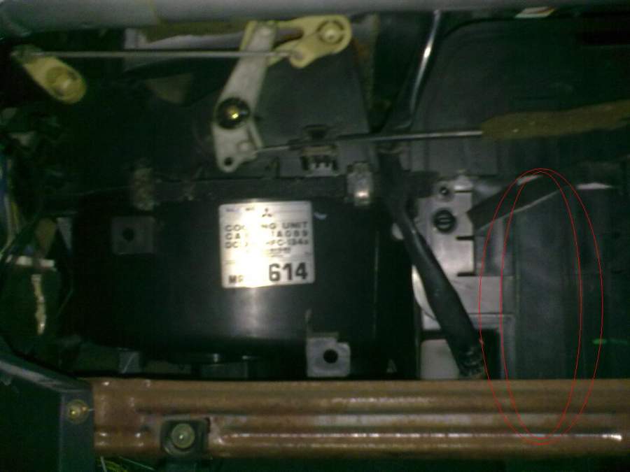

<blockquote data-quote="diesel_kiki" data-source="post: 4153586" data-attributes="member: 86576"><p>the actual location 4 the cabin air filter is red circle (refer to pic)..</p><p>but their don have cabin air filter inside just slot to put only..</p><p>what u need to do go 2 aircond mechanic 2 service ur aircond (change exp. valve, evaporator chemical service, and change receiver drier) and ask to pomen 2 mod ur cooling coil casing by simply cut the slot, and put cabin air filter,so next time, u no need to remove cooling coil cleaning, just change or just tembak angin cabin air filter, if dun get mitsu one, i think u can put waja denso or patco caf..</p></blockquote><p></p>
[QUOTE="diesel_kiki, post: 4153586, member: 86576"] the actual location 4 the cabin air filter is red circle (refer to pic).. but their don have cabin air filter inside just slot to put only.. what u need to do go 2 aircond mechanic 2 service ur aircond (change exp. valve, evaporator chemical service, and change receiver drier) and ask to pomen 2 mod ur cooling coil casing by simply cut the slot, and put cabin air filter,so next time, u no need to remove cooling coil cleaning, just change or just tembak angin cabin air filter, if dun get mitsu one, i think u can put waja denso or patco caf.. [/QUOTE]
