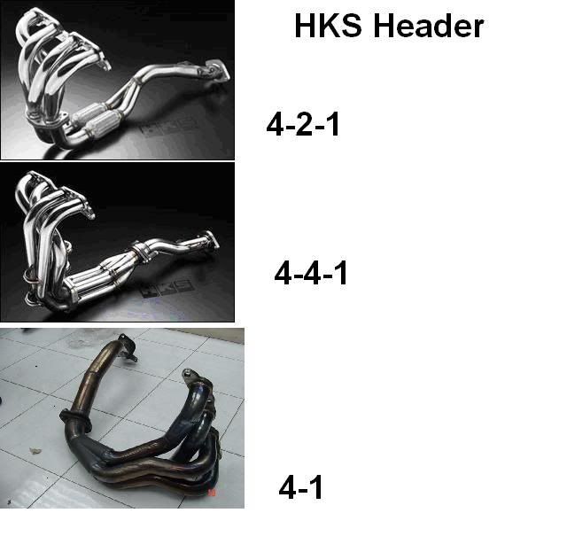

i think 4-2-1 more popular was due to have 2 flexible nenas. There for less vibration. Pic2 and pic3 dun hv nenas
Anybody try the pic2 and pic3 b4? any comment?
Well.. as for the flexpipe (nenas), most racing headers don't have them. This is because the flexpipe will cause flow restriction which may cripple performance.
Those with flexpipe is more suited for street use and of cause can withstand more vibration. If the extractor don't have flexpipe, it can be easily fitted between the downpipe and midbox. Flexpipe can be easily found on chopshops... just get the smallest length possible.
