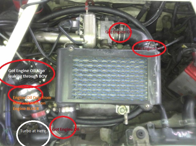

2nd try - Due to high RPM(electronic tuned) & Discovered i used rubber hose wrong due to engine block heat, Which leaked at EGR head n i change to radial type hose. Removed the intercooler (discovered Engine Oil nearby the intercooler connected hose - refer engine bay jpg).

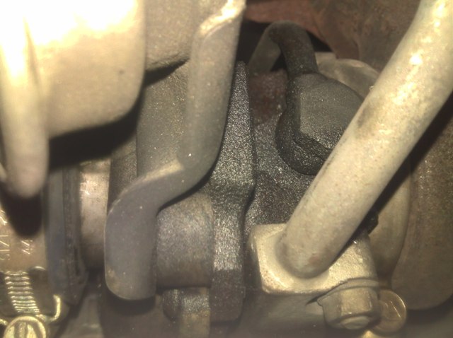

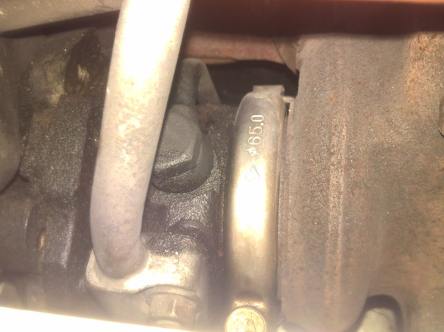

2) I want to double confirm is my turbo leak/spoiled due to discovered oil at the connection point? - refer Turbo View 1 & 2 jpg.
