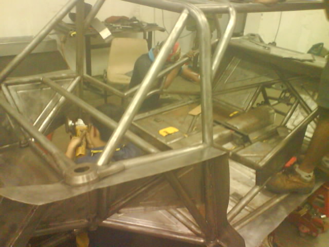

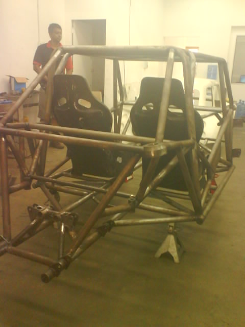

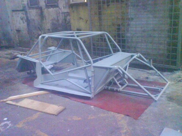

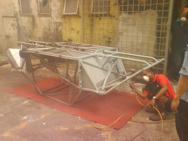

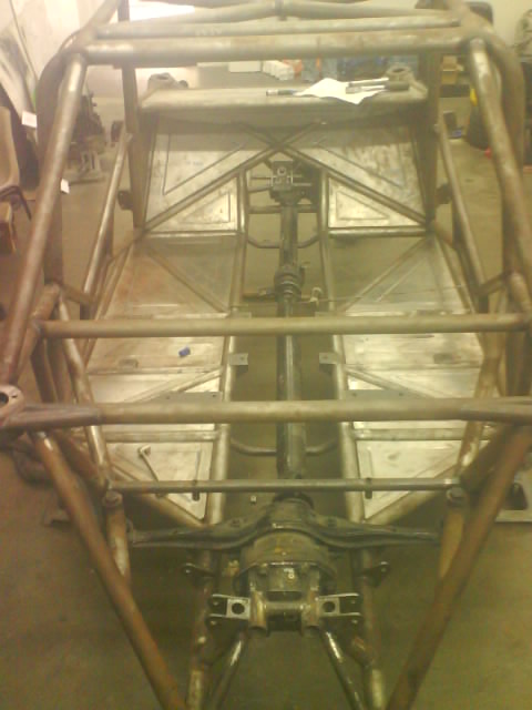

Now focusing on main project, almost finished the chassis, by next week can prep and spray already. Hopefully can finish before March...
finish prepping already today, tomorrow 2nd layer primer
