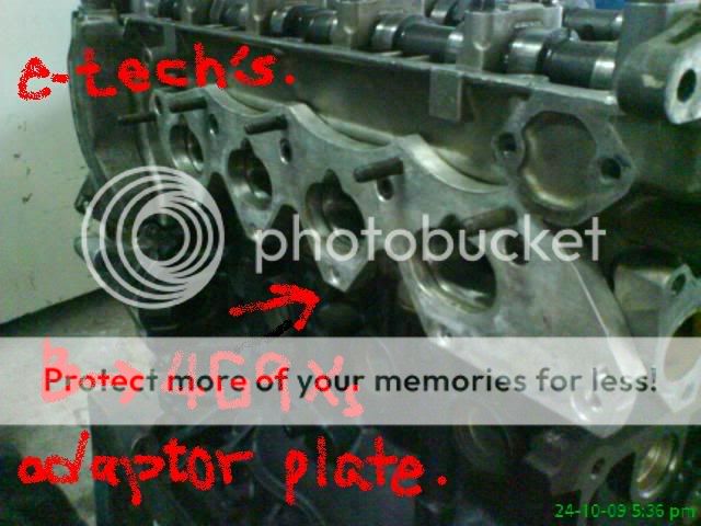

Hello Bro E-tech.....
Just asking....the thread hole for mivec and another one is for vtec...its true...:confused:
Bro
No. The other way round.
Thread hole for Honda intake.
Hole only for screw to mivec head.
Go buy a b16a intake gasket, then u easy
understand...

i buy 4g93T intake then i notice there is extra hole at 93na. Can we just plug n play 93t to 93na without cover the hole at the head?
