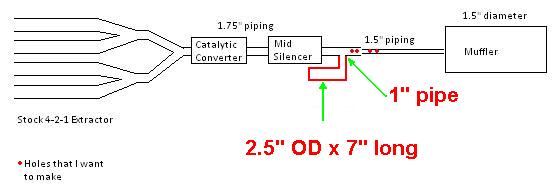

Guys and seniors... I have an issue here that is too much backpressure.
The story is like this... When I bought my Corolla AE111, 4AFE as a second hand, the driver fixed a straight flow muffler with 2.0" dia. inlet and 2.5" dia outlet. This is too noisy and i find the bottom end too weak.
So I changed it back to the s-flow type muffler. The prob is, the dia of the muffler is 1.5". I didn't know before this. The guy only tell me after it is fixed. The original pipe size for 4AFE is 1.75". Torque from 1k - 2.5k rpm is really great but after that, the power is rubbish. no mid range torque. Difficult to accelerate.
To summarize,
At first, my piping was 1.75" and modified to 2.0" towards the rear.
After fixing, my piping was 1.75" modified to 1.5" towards the rear.
I just want to ask is it possible to lower the backpressure by puncturing a few small holes somewhere at the rear of the exhaust piping? I wouldn't want to change the muffler already as I spent a lot of money on it. Can it cure the mid-range torque kill?
Please refer to the diagram on where I want to puncture the holes.
Any sifus can advise? Thank you and really appreciate it!
hey man, i doubt the holes is gonna improve anything.. i think its gonna make things worst.. the flow characteristics is gonna be all over the place.. i dun really see a solution but to change the muffler and get a 1.75in inlet one..

Veloc....i think it'll be better to just change back to 1.75".
Agree and highly recommended.. That's the best setup for power and consumption balance..

Change muffler? That is sad... Have to spend a bunch again... In that case, guess I'll just have to bear with this until I collect enough money to swap in a blacktop straight. Do not want to spend a lot on this engine now... I have already spent enough when I acquire this car as the previous owner is a noob in maintaining car. I am just looking for a low cost temporary solution...
So making some holes really wouldn't ease the backpressure huh?

Heh chill bro.. just change the 1.5" section to 1.75". Should not cost too expensive. Please bear in mind that it will still semput around 4500-5000rpm. This is normal for 4AFE. Sifus, pls correct me if i'm wrong.

Cannot bro... The inlet of the muffler is 1.5". Nevermind... Guess I just have to bear with the loss of mid-range torque for around 2 years i hope? Then change to BT.

Ah i see..I thought only the piping is 1.5" because u said "towards the rear'..sorry bro.. Anyway, yeah, have to fork out another 180-250 for a standard SEG muffler.

Pressure can be reduce but flow will be still restricted.
