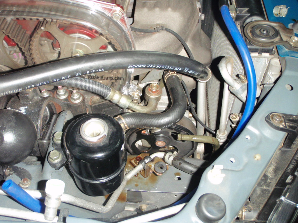

<blockquote data-quote="pangyau" data-source="post: 4512586" data-attributes="member: 82450"><p><strong>Re: [HELP]: Steering Squek After Changing Steering Fluids</strong></p><p></p><p>Thanks PabloIceman & xtremeleo (for the guideline)</p><p></p><p>I already solve the problem by changing to Dexron III (suitable for steering oil).</p><p>The Motul ATF-1A change to dark color after 3 days use (only less than 70km)</p><p>Done the flushing + bleeding cost me almost 3 liter. </p><p>The squeak sound has been reduce.</p><p>I also asked & compared to other EVO in here & all the same. </p><p>Lock-to-lock (hard right/left) position also squeak but not too loud... </p><p>Can be notice if open the hood.</p></blockquote><p></p>
[QUOTE="pangyau, post: 4512586, member: 82450"] [b]Re: [HELP]: Steering Squek After Changing Steering Fluids[/b] Thanks PabloIceman & xtremeleo (for the guideline) I already solve the problem by changing to Dexron III (suitable for steering oil). The Motul ATF-1A change to dark color after 3 days use (only less than 70km) Done the flushing + bleeding cost me almost 3 liter. The squeak sound has been reduce. I also asked & compared to other EVO in here & all the same. Lock-to-lock (hard right/left) position also squeak but not too loud... Can be notice if open the hood. [/QUOTE]
