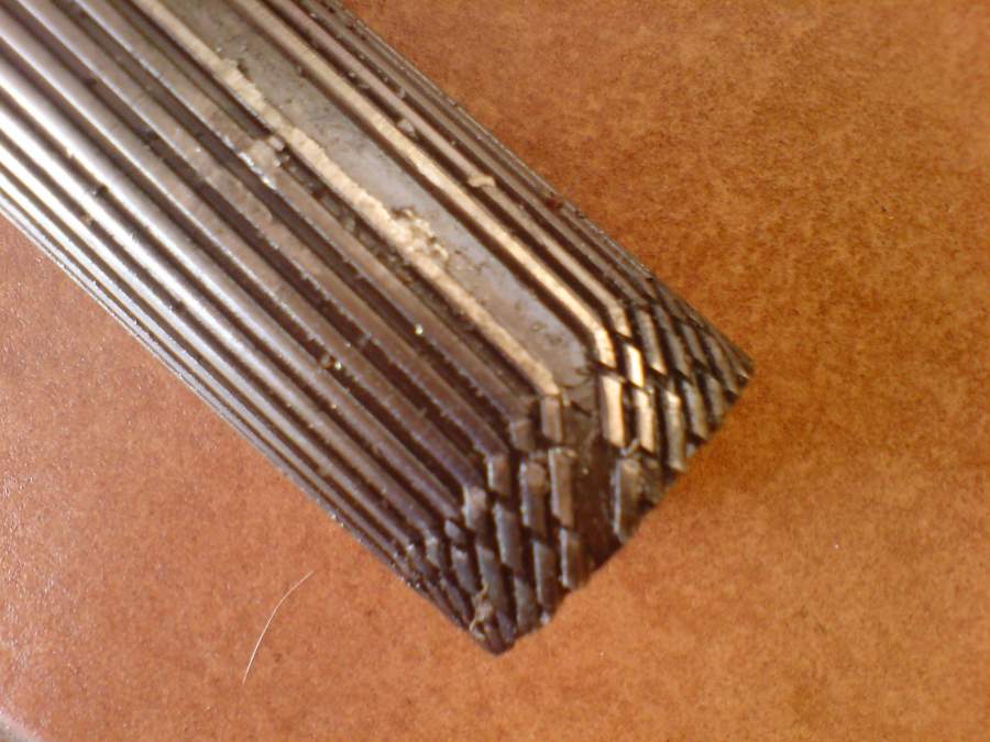

I own a Mitsubishi Lancer 95,which the tail light same as Evo 4,5,6. Few months ago I had bought a Evo5 halfcut,and I thought it totally fit my lancer,eventually it doesn't. Now my car only running on 2wd,and without brembo at rear. Few days ago,my car broke down. And after my friend takes my gearbox out of the car,we found that..I don't know what we call that,might be the "shaft" inside the gearbox has snap into two. and the thing on the other picture,we custom made it.
My Question is..
1.Evo5 lock 4wd,the power will be less 50% ? (like what my friend locked,the power of the car is powerful,but he told me the "shaft" cannot stand for too long. unless i drive slowly,then it won't snap into two.)
2.One of mechanic which is from KL want to charges me RM800 for locking 4wd. and he said the power of my car will not be less than current,and the "shaft" will not snap into two like now. Is that believable?
3.Anyone faces the same case like me? Or anyone driving evo 4,5,6,waja with evo engine which is running on 2wd,so far your car got any problems?
I afraid that after I let the KL mechanic lock the gear,my car left 50% of power. My friend told me one idea which my "shaft" won't snap into two,but my car has only 50% of power. How to make it 2wd and also with 100% of power?
Please give me some idea,thanks alot!

err no such thing la bro , the evo5 gb if locked to 2wd will deliver jst as it supposed to
my mech changes much lesser than tht, not more than rm300 to lock it for evo456, its matter of opening and welding
I heard that evo1,2,3 lock 4wd are very easy,and the engine still afford to support 100% of power of the engine. But for evo4,5,6 might be a bit hard,because the "shaft" in the gearbox is only support the front,unlike evo1,2,3,they are sharing a "shaft" from front to back. That's why the "shaft" in evo4,5,6 could snap into two. am i correct?
for evo 4,5,6 is not locking on the gearbox but lock on the center diff, if previously thegearbox is lock on the gearbox are wrong.
wow... the bottom part is twisted eh?

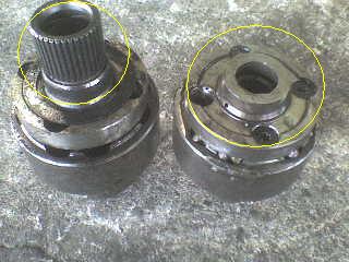

The transfer gear at the right hand side one is mine..Last time my mechanic cut away the shaft that i had highlight. See the different within the two transfer gear. and what is the use of the shaft? Is to push 4wd?

No,the first time I lock 4wd,my mechanic cut off the shaft. Now the KL mechanic told me that without the shaft I cannot lock 4wd (by his own way to lock,I don't know whether the way he lock is like the way your mechanic lock or not). So he ask me to buy a new transfer gear to lock. Another thing that makes me confuse is,after we lock 4wd,can we re-open it? Means now I lock 4wd,may be after few months,I want to make my car 4wd,can I re-open it?

It really depends how your mechanic lock your gearbox, some do it after shaft some b4. If u plan to quietly go 4WD i suggest u ask the mechanic doin it for u. But I think best is drive slow slow now, kautim jpj n all those stuff then only quietly 4WD.
