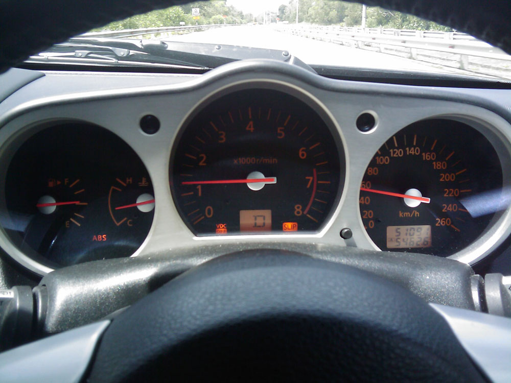

<blockquote data-quote="RebeLZ" data-source="post: 4238280" data-attributes="member: 77752"><p>im not sure if its the same or not. this was the problem i had before..</p><p></p><p>mine used to lights up the VDC, SLIP and ABS. ask other 350z forums and they ask me to check the brake pads.. </p><p></p><p>it might lights up if ur pads is thin. after u change the pad, check if ur brake oil is inline with the F indicator at the brake reservoir.</p><p></p><p>all the warning lights was gone right after that. if yours still on, i thinks its because of abs faulty sensors or worst case faulty ABS. because u told me that ur engine is slowing down.. just my 2 cents here.</p></blockquote><p></p>
