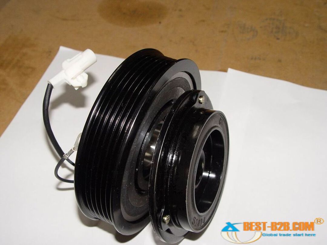

the assembly looks something like this...those 2 pieces have barely a millimeter in between them when put together. pulley is free spinning, outer part is the clutch that's connected to the compressor. when u turn the a/c on, the *tak* sound u hear is the clutch sticking (magnet on!) on to the spinning pulley to spin the compressor to work your a/c.
Sometimes for whatever reason these two get too close and may rub, hence cause the noise you're hearing even when the a/c is off.
Remember tho, this is just a guess, your mechanic should be able to check to confirm like jimmyae101 mentioned. could be a problem with the compressor itself...?
