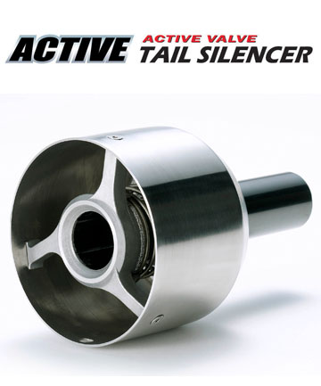

also can opt for this...or something similar...simple solution...2 in 1...closed when low pressure = silence... WOT high pressure valve opens = noisy...
or use the manual exhaust control valve via cable... like D7zul did...
Cool, does it really help? Where to get this and how much does it cost?
Soundproofing my car would be adding a lot of dead weight =(
Yes, I think so. Will be loud only when at high RPM when valve opens.....
