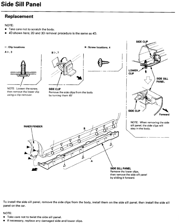

<blockquote data-quote="shiroitenshi" data-source="post: 1551513" data-attributes="member: 27518"><p>It's a PDF file, use acrobat reader. </p><p>Free program.. here --> <a href="http://www.adobe.com/products/acrobat/readstep2.html" target="_blank">http://www.adobe.com/products/acrobat/readstep2.html</a></p><p></p><p>anyway for immediate use, I'll post this.. but seriously, keep and use the manual, it's very handy for a lot more diy stuff.. can buy seats and install yourself, can do a lot more DIY stuff as you buy things, no need to find time to leave car at workshop.</p><p></p><p>Learn the page numbers for each section too (as you find each sections first page, where it shows the page numbers).. write it on a piece of paper or something, since the original has colored tabs to seperate each section, and the PDF doesn't. I do this so often that I remember the page numbers of the PDF file of the EG manual.. Body - page 775 on the PDF.</p><p></p><p>Lucky the older gen cars manual can find.. the newer gens very hard to find now.. all have to buy from honda UK. (dunno if the local HM stock or not)</p><p>Here's a shot from the part you want from the same PDF your downloaded from the site I gave you. </p><p></p><p>[ATTACH=full]606695[/ATTACH]</p></blockquote><p></p>
