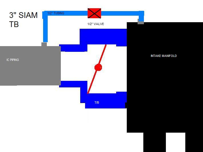

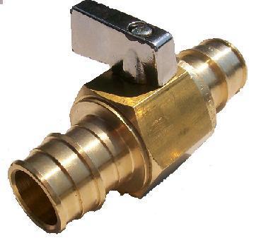

<blockquote data-quote="nan83" data-source="post: 3072093" data-attributes="member: 6718"><p>SIMPLE & EASY.... just regulate the valve to increase idle..... you also can install solenoid valve for your cold start purpose.... but please use min 1/2" tubing & 1/2" valve.... if kecik sangat, not enough air flow... nanti idle 300rpm susah... wekekeke....</p></blockquote><p></p>
