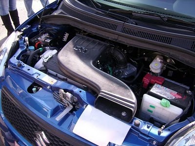

I wanna install a open pod filter so i need a length of ram pipe to let the filter suck could air.....i want to custom one ~ but in between the filter and the throttle body,there must be a MAF sensor on the ram pipe to let it count the air-flow.....so i need a flange that can let the MAF sensor to be bolted on.....anyone know where can i get the flange or where have this kind of custom services ?
Thanks =)

Bro, no need to custom made, u can buy it off the shelf. I bought one of those generic ram pipe for Wira, saw it off to shorten it to accommodate the MAF sensor, for the flange can buy it off the shelf also, be it made from plastic or aluminium.
Just be 'rajin' to visit the acessories shops to get what u want, can try 'Kedai Abang' first .....

The problem was,the ram pipe was so short and charges for such expensive pipe.... 1 pipe cost 180 bucks.....i can custom longer then 2x the ram pipe for under 100 bucks ~ but the problem was i doesn't have the flange for the MAF sensor ~ hmm =S
errr...care to share your MAF sensor+stock airbox picture???
i've seen some ppl using those flexible rami-air pipe as replacement intake pipe from airbox to throttle body...(retain original MAF sensor and air filter)
in your case a bit risky la..u need to remove the MAF from stock airbox and DIY the adaptor using aluminium cake pan (buy from acehardware) <<this need to do some metal cutting,drilling and seal with silicon glue (those usual used on aquarium to seal your adaptor)
