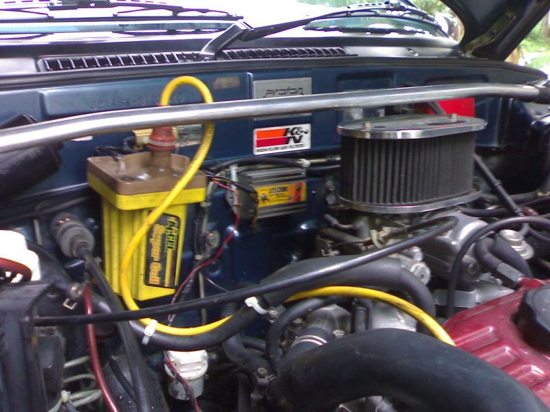

cipan_supercas:bro wat brand is your ignition coil and for what car one?how much you bought it?and what is the thing under your k&n sticker?mind telling me?
its the cdi...thats the thingy that controls the voltage to the distributer so that your distributer will not be fried...

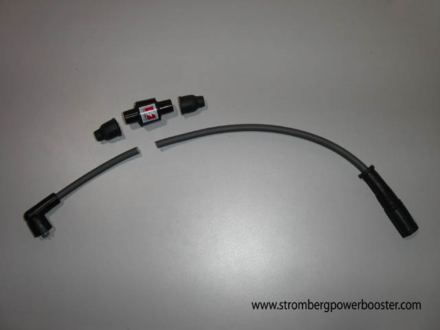

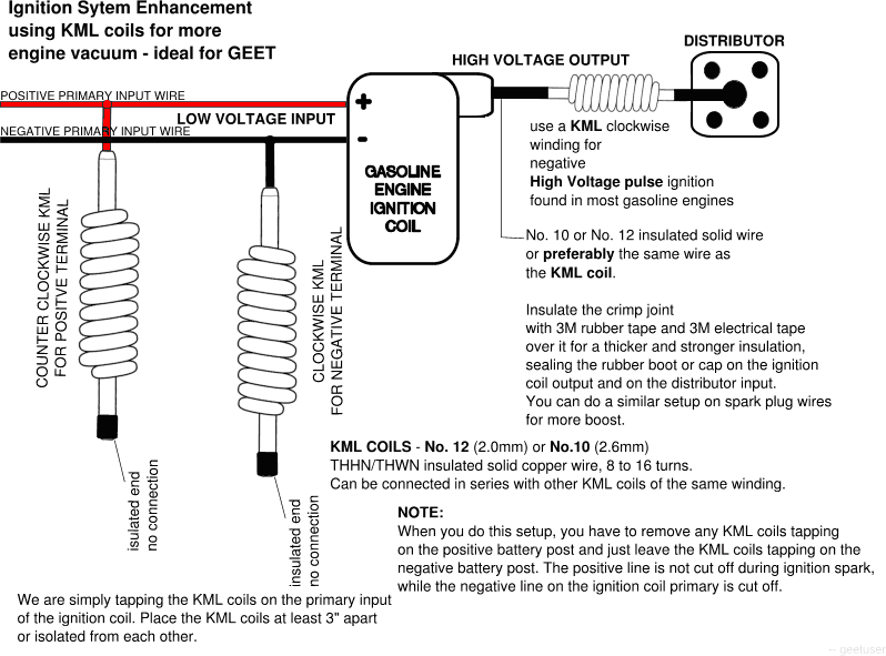

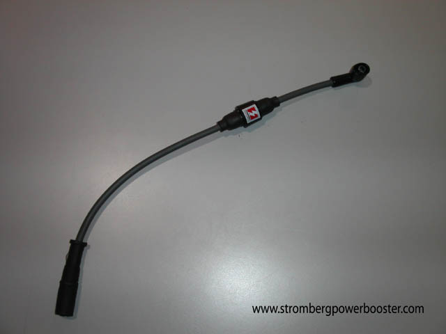

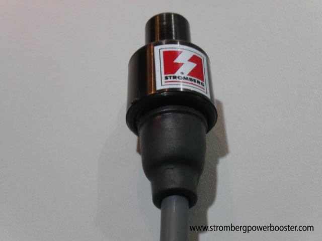

Ignition booster by KML wire setup. Anyone interest can DIY it too.You can refer to the video i share for more understanding. And the idea also use by one big company. If not clear please double click the picture for large format.

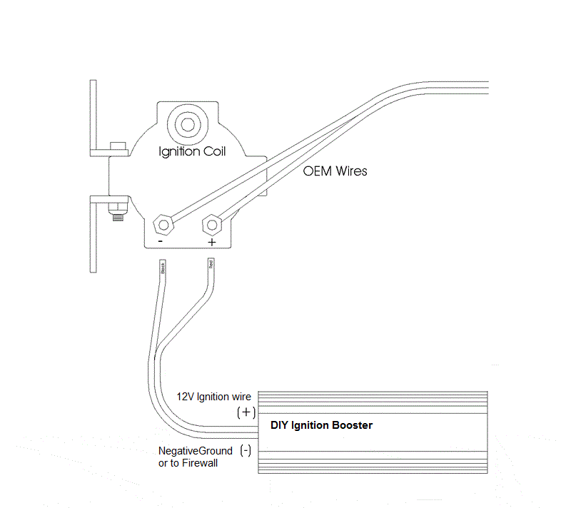

If using normal VS,how it should be connected to serve as a spark booster?
Refer to the above post with picture show the connection of diy ignition booster to the ignition coil.
Normal VSD should served the same they are all capacitor, nothing but just capacitor. But once much keep the VSD away from the heat, recommended insulate them with heat resistant material.

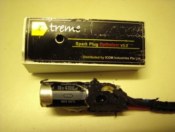

How many have build this? How many times you replaced exploding capacitor 4,700 mfd / 16V?
Capacitor working voltage was wrong. It must be above protection voltage of ZK44 of 40V. So, you need to use 4,700 mfd /60V to avoid blowing off top of capacitor as shown in the picture.
I don't think that this will improve the spark voltage of ignition coil. Because the circuit was in parallel with primary winding of Ignition. It will only suppress High Voltage on secondary winding of Ignition Coil. Initial Voltage will be reduced and remaining spike or oscillating voltage will be totally cut-off . Causing the suppose to be 2 spark to become 1 spark only at reduced high voltage.
This only my only circuit analysis.

Just looking at the diagrams you posted and hmmmmm. I can not see how placing these kml coils on the 12 volt +ve side of the ignition coil will affect engine vacuum. Placing one on the -ve side serves no purpose either as its ground. Looking at the black picture of how the inline device is designed confirms my belief that it will have no effect. The spark plug wire is cut and one end is connected to this device which has a metal plate, a spring and another metal plate. The other half of the spark plug wire is connected to the other end of this device. Nothing has changed other than increasing the length of the spark plug wire. One thing that would help IF the spark plug was fouled would be to pull the spark plug connector away from the tip of the plug so that the spark jumps from the connector to the tip of the plug. That will "force" the plug to spark. The reason this works is with regular ignition, the delivery of high voltage to the spark plug occurs gradually. During that buildup the fouled plug can actually absorb the energy and short it away. When I say gradually, I mean a couple of millionths of a second. When the plug cap is pulled back so that the spark can jump, the delivery of energy is instant and the plug is not capable to bleeding it off. There is absolutely no delay. The buildup is in the plug wire until its high enough to jump to the tip of the plug. This has absolutely no effect on improving performance; it only addresses a problem of a fouled plug. People who ride small 2 stroke motorcycles are most likely to see this especially if they lay down a blue/white smoke screen riding normally.
