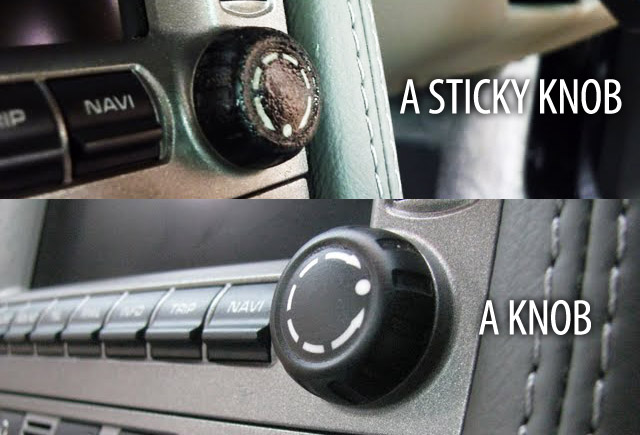

'(00): Find yourself touching a sticky knob? It almost feel like the rubber's melting, but wait. Meet KC. Watch as he de-rubberize the knob, documents his detailing chronicles renewing a 997 CS and hundreds of step-by-step pictures and generous tips and tricks on car detailing.

most commonly problem any Germans ride face here.....my buddy thought Malaysia is too hot...so hot till our weather melts the knobs ....
Most probably you don't find in any other car maker ...as they are not rubberised
this is a very common known issue in other German Marque Machine ....esp in E60s, E90s...many many many more...it is build for 4 season climate ...perhaps tropic is too hot
ta da
It is only clean with Power clean & microfibers !!!! Many refuted my claims of this de-rubberised detailing - makes no sense & got the wrong picture after :-
knobs are misleading... you took a picture of the left one for before and then the right for after.....they were in two different conditions... you can see that on the picture when you see both...
I'm just curious how u restored the rubberised a/cond knob in the 997. The before and after pics don't tally, the bad one is on driver's side...show us that one after u rescue it, not the one on passenger side

before
Now
close up shot
5 months later on the left knob - still remains

thanks to this knob & the pic
who got me into trouble and many have refute my claims
Now
