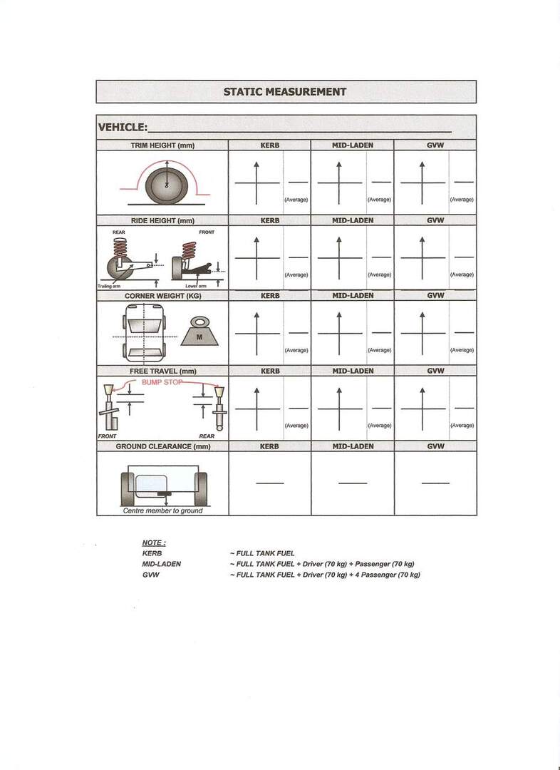

For a start I would like to get a data on Trim Height of our standard DC5 with stock suspension and tyres 215/45/17. Trim Height is the distance between the wheel centre and the wheel arch. It's quite easy to measure just using a measuring tape, however, the condition of the car must be:
1. Car must be level on a flat surface like a 4-post lifter/hoist (if your house garage is flat also can)
2. Kerb weight (Full Tank Fuel)
Since I didn't take the measurement last time on my car, I would appreciate those who still with the stock condition to provide it. If you have lightened your car a bit thats okay since it's difficult to get bone stock car coz most of us sure mod it rite after getting the car.

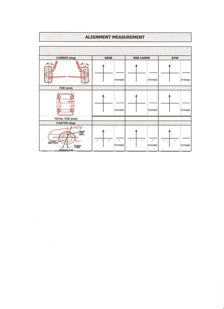

I also attached 2 forms for everyone who's interested to use the forms for your own record. These are some of the forms I used last time when doing R&H development. The cross with arrow in the form is for us to write the FrontLeft/FrontRight/RearLeft/RearRight measurements. Pls use millimeters(mm).
(note: ground clearance of DC5 not from centre member but from our exhaust since thats the lowest point, the one in the form is for proton cars)
