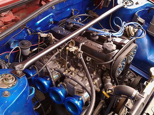

<blockquote data-quote="EFN" data-source="post: 4137374" data-attributes="member: 1416"><p>1JZTezza, this Starlet will serve three distinct purposes. When I received the whole URS/Mikuni assembly - it was indeed jetted with 200 Air Jet/150 Main Jet/57.5 Pilot Jet which were meant for cams with 272-288/9mm lift. For daily road use, I am acquiring 120-130 Main Jets to go with the 256/7.9mm cams. But in battle mode, I will swap in a 288/9mm cams which is intended to give powerband within 6000-9000RPM. - This setup is for SIC Track Days and Sprint Events. For AutoX the setup will be similar to Road setup.</p><p></p><p>I am quite happy with my ignition system now as it fares very well with the somewhat rich AFR. Using stock Toyota coils will have tendency to bog the revs.</p><p></p><p>And yes the fuel pump has been upgraded as well, using Mitsubishi Electronic carb pump which is quite fast is float spool (stops when it is full). Since using it no more shortage of fuel supply :)</p><p></p><p>My kambeng is still in the process of tuning and I would expect to do it still on regular basis to suit different needs :)</p></blockquote><p></p>
[QUOTE="EFN, post: 4137374, member: 1416"] 1JZTezza, this Starlet will serve three distinct purposes. When I received the whole URS/Mikuni assembly - it was indeed jetted with 200 Air Jet/150 Main Jet/57.5 Pilot Jet which were meant for cams with 272-288/9mm lift. For daily road use, I am acquiring 120-130 Main Jets to go with the 256/7.9mm cams. But in battle mode, I will swap in a 288/9mm cams which is intended to give powerband within 6000-9000RPM. - This setup is for SIC Track Days and Sprint Events. For AutoX the setup will be similar to Road setup. I am quite happy with my ignition system now as it fares very well with the somewhat rich AFR. Using stock Toyota coils will have tendency to bog the revs. And yes the fuel pump has been upgraded as well, using Mitsubishi Electronic carb pump which is quite fast is float spool (stops when it is full). Since using it no more shortage of fuel supply :) My kambeng is still in the process of tuning and I would expect to do it still on regular basis to suit different needs :) [/QUOTE]
