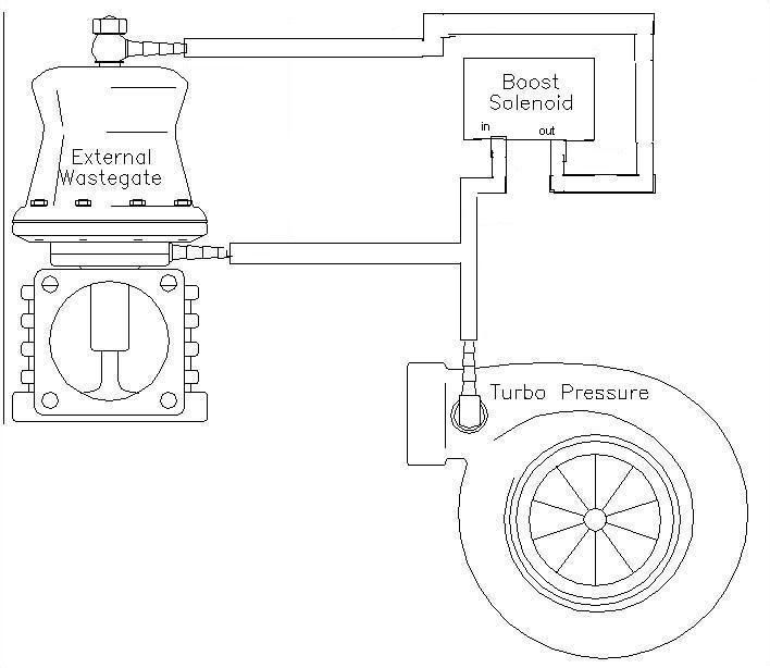

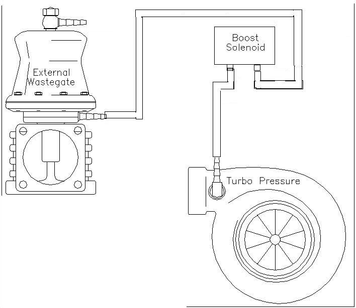

<blockquote data-quote="FatAssRubber" data-source="post: 2046620" data-attributes="member: 48972"><p>answering to normality, </p><p></p><p>the second setup creates a pressure to hold the diagphram tightly close during boost building. less chance of premature boost leak.</p><p></p><p>Only needed in high boost scenario. Stock toyota, less than 100kpa (1 bar/ 14.7 psi)... not really effected.</p><p></p><p>fatty</p></blockquote><p></p>
