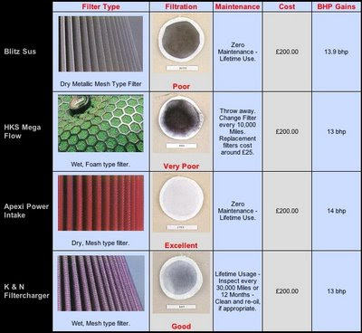

<blockquote data-quote="slide_it" data-source="post: 3898455" data-attributes="member: 57636"><p>AIR FILTER AND DOSE PIPE FTW!!!11 </p><p></p><p>CROO CROO CROO CROO</p><p></p><p>http://t3.gstatic.com/images?q=tbn:Az3nY0xZHwG2BM:http://i33.photobucket.com/albums/d70/mr_crust/985459fb.jpg</p><p></p><p>in all seriousness...</p><p></p><p>blitz - more airflow but less filtration</p><p>apexi - good airflow and good filtration</p><p>hks - good airflow and oil based filtration</p><p>k&n - good airflow and oil based filtration</p><p></p><p>u hav to bear in mind that with oil based filtration systems, it tends to collect crap on the AFM sensor (unless of course if you are running MAP sensor). too much crap on the AFM sensor may lead to ur engine spluttering and sounding like a wrx on fit. with oil based filters u have to maintain it pretty regularly, cleaning the sensor by using an electronic contact cleaner.</p><p></p><p>ill leave it to you so pick which is best for ur ride's application.</p></blockquote><p></p>
[QUOTE="slide_it, post: 3898455, member: 57636"] AIR FILTER AND DOSE PIPE FTW!!!11 CROO CROO CROO CROO http://t3.gstatic.com/images?q=tbn:Az3nY0xZHwG2BM:http://i33.photobucket.com/albums/d70/mr_crust/985459fb.jpg in all seriousness... blitz - more airflow but less filtration apexi - good airflow and good filtration hks - good airflow and oil based filtration k&n - good airflow and oil based filtration u hav to bear in mind that with oil based filtration systems, it tends to collect crap on the AFM sensor (unless of course if you are running MAP sensor). too much crap on the AFM sensor may lead to ur engine spluttering and sounding like a wrx on fit. with oil based filters u have to maintain it pretty regularly, cleaning the sensor by using an electronic contact cleaner. ill leave it to you so pick which is best for ur ride's application. [/QUOTE]
